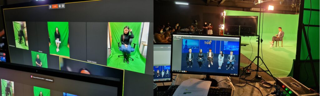

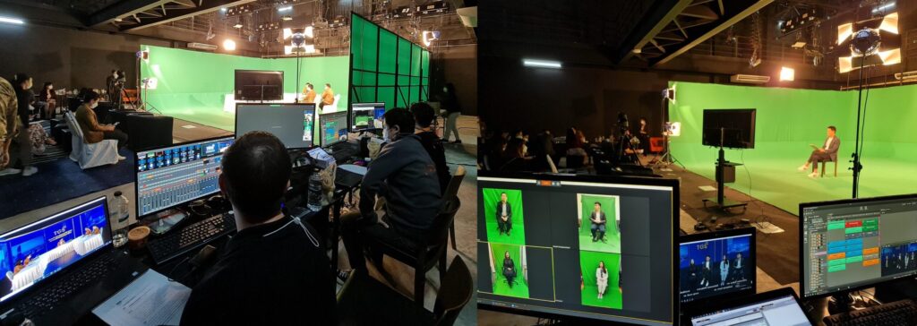

With only one day available for setup and rehearsal, the solution had to work perfectly out of the box. The virtual studio was first designed by Vizrt Thailand using Viz Artist 4, and then the team had to work out how to meet one of the key components of the brief, ensuring the President of the TGS could interview four students live, each dialing in from different locations in the UK.
“With the Live Call Connect feature that comes with our Live Production Suite, we can bring in any Callers from applications like Microsoft® Teams, Zoom®, Skype and so on,”explains Pahuton Sriwichai, Solution Architect, Vizrt.“In this event, we used Zoom Meeting allowing the four scholarship students to join the Zoom call. Viz Vectar Plus, our software switcher, has an integrated function that allowed us to easily bring these four scholarship students, each shot against green screen, in different sources without any additional devices required. We then routed these feeds back to the Vizrt XR Set using Viz Vectar Plus, so they could be used as camera sources with green screen and combined into the same Virtual Studio set.”

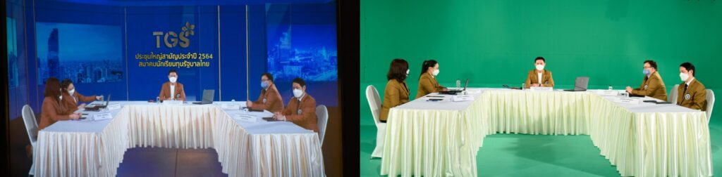

An NDI®-enabled Panasonic PTZ Camera was set up at the center front of the green screen in the main studio space for capturing the President, who was also hosting the interviews. The PTZ camera sent the camera signal to the Viz Engine, and simultaneously sent the tracking data to the tracking hub application. As the four scholarship students were also essentially inputs into the Viz Engine, the PAN/TILT/ZOOM functionality of the camera was reflected in all the input’s sources.
The result was very impressive. The students were all shot in chairs against green screen and then dropped into the virtual set, so it seemed that they were all sitting in the same studio and being interviewed in real-time by the President.

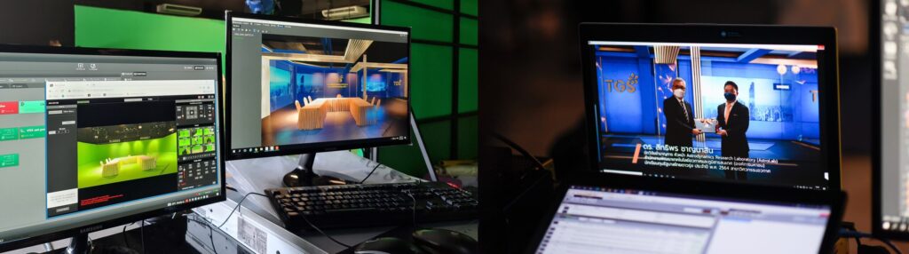

Viz Arc was used to both control the VR/AR graphics and fine tune the Precision Keyer, with the intelligence of Precision Keyer enabling the operator to do some fast fine tuning even just in a few minutes while the team was changing the set.

“Vizrt’s Graphics Solution played a big role too,” says Sriwichai. “The Viz Trio system supports advanced 3D real-time graphics for any type of CG content and allows the operator to update the content right up until the very last minute before the CGs go on-air.”

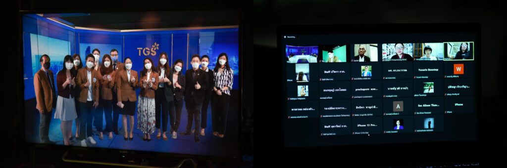

The event was a runaway success, delivering the largest audience for a seminar yet, and has led TGS to rethink the way it will run future summits even when the pandemic is fully over.
“One thousand people watched our seminar online so I think that in the near future we will be able to do it as a hybrid version,” says Dr. Sawadsri. “Even if we have the onsite version perhaps, we can also do a broadcast in real-time online such as in the way Vizrt helped us this year.”
