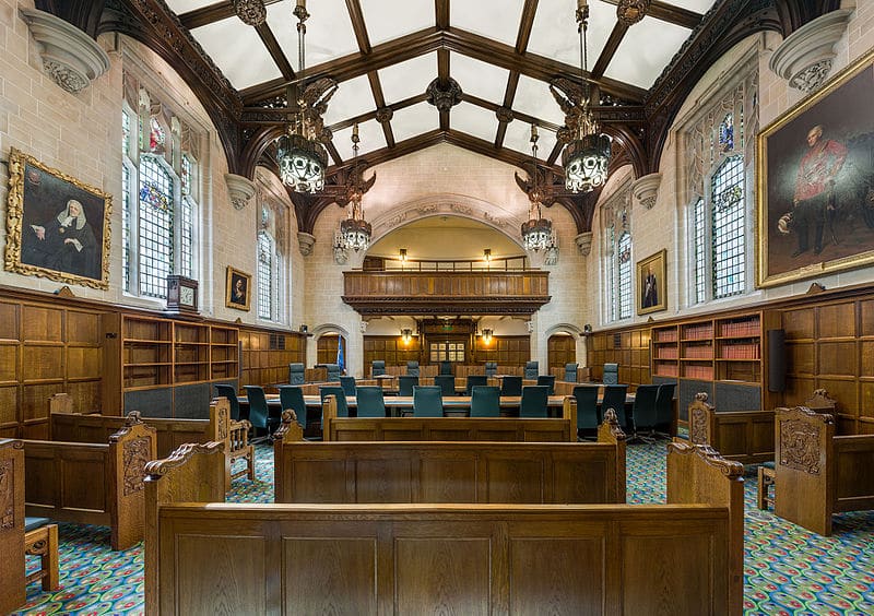

The main courtroom at the United Kingdom Supreme Court where a Brexit case reaching 4.8 million viewers was heard. Note the Panasonic PTZ cameras located in the upper corners of the room

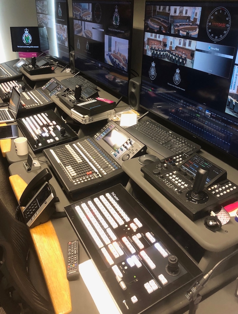

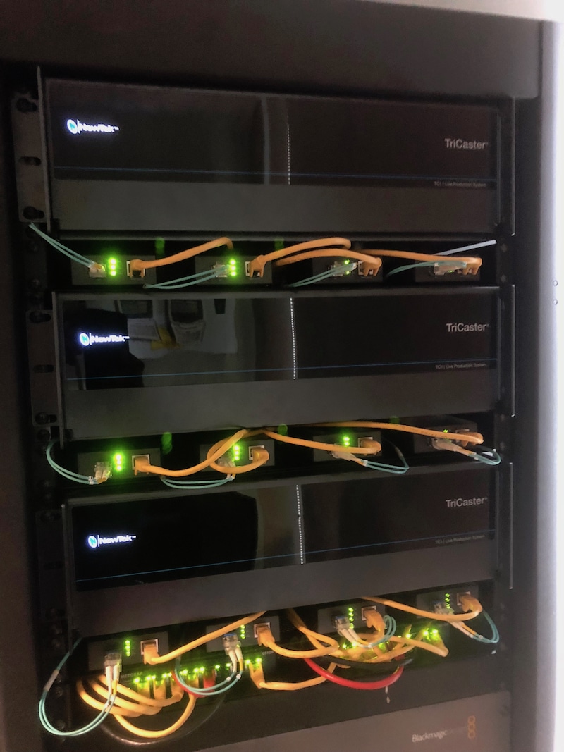

The United Kingdom Supreme Court uses 3 TriCaster TC1’s located in this confined space. Shown here are the control surfaces and video displays for each courtroom. One TC1 per courtroom.

Three TriCaster TC1’s connected to cameras via NDI in each courtroom. Minimal space and cabling required, every two TC1’s act as backups to the other one. NDI drastically reduces the amount of cabling required using the building’s local area network to transmit video signals.
Each courtroom has four Panasonic PTZ 1080p 50fps cameras that go to the production control room where the operators mix, record, and output to the streaming platform. There are three TriCaster TC1 digital media production systems, one for each courtroom. This also provides backup and resiliency. Everything can easily be switched to another system as all sources are IP, so the cameras are available to connect instantly with no downtime.

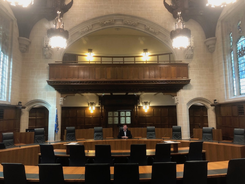

One of three courtroom’s inside the United Kingdom Supreme Court in London. This courtroom hears cases from other countries within the Commonwealth. Note the Panasonic PTZ cameras above. These cameras are controlled from the main control room where the TriCaster TC1’s are located.
